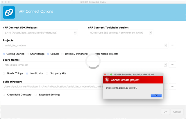

Thx for that. That method builds OK (i.e. I don't see any errors) and generates the .hex file.
Still can't build with SES (see error below).
I have not tried to reinstall the toolchain as yet. Do you think that would fix this error
create_nordic_project.py failed (1).
? which looks more like a file protection problem.
Thx.
I see. I just updated to Big Sur an SES (Nordic) 5.10d and now I get the same error as you see. I have not found an explanation for this or workaround yet, though.
Update on this. In my case the issue was that I had not updated the paths correctly (after moving things around). Perhaps you did the same, or forgot to set zephyr and toolchain base in the first place?
Before opening a NCS project you need to start SES, then go to Tools -> Options ... and select nRF Connect. Then you need to set the two Directories correctly. In my case it is like this, but you need to adjust it for your setup:
After that, you should be able to open a NCS project from File -> Open nRF Connect SDK Project...
Thx but ...
If you look further up this post you will see that I have indeed set those correctly
Ah, sorry. I did not remember that. But now I spotted another issue, which would also give you this error. You have specified the wrong board. You ned to use nrf9160dk_nrf9160ns. It is not possible to run sample projects that use the modem in any thing other than non-secure mode (ns).
get the same error with that board. Also tried to build blinky. same error.
Hm, then I am not sure... Can you show the log form SES? (you will be able to see it in the lower part of the SES window after you click OK on the error message).
ok. after a couple of tries I got the log:

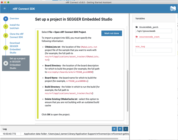

2 things bothering me. fFrstly if you look at the image showing the red error message you will see that the Toolchain version is not set (cannot be set).
Secondly in the Connect SDK there is a side panel to show settings such as ncs_tag. Should these be blank. The GnuArmEmb_path is not the one I have set.
Is this OK?
paul_tanner said:2 things bothering me. fFrstly if you look at the image showing the red error message you will see that the Toolchain version is not set (cannot be set).
I do not see any error message. Can you clarify?
paul_tanner said:Secondly in the Connect SDK there is a side panel to show settings such as ncs_tag. Should these be blank. The GnuArmEmb_path is not the one I have set.
These are used for the getting started assistant to verify your steps. It makes sense to set them correctly when using the getting started assistant, but it does not have any other consequences.
