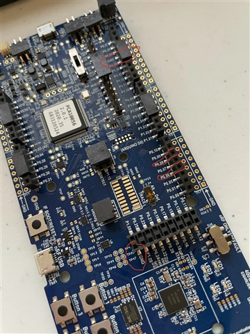

    One last question. If I were to use the first method, where I use a TTL to USB converter, I just want to confirm the pins to be used. Please consider the below snapshot.
    On the pca10056.h, the RX_PIN_NUMBER is 8 and the TX_PIN_NUMBER is 6. So, I should just connect the circled two pins (P0.8 and P0.6) correspondingly to the TX and RX of the converter?
    Then, the last step of selecting the ground. As you have mentioned, any digital ground would suffice. For my nrf52840, would the other two circled locations work?
    These are the only three pins I need to connect to the converter, I wonder am I correct? In the .h file we also have CTS_PIN_NUMBER = 7 and RTS_PIN_NUMBER = 5. I wonder do I need to connect those as well?
    Really sorry for disturbing you. Hope that you could help me with this.
    Jinyue
  • Yes! You are correct. P0.8 as rx and P0.6 as tx. connect the node which are red circle from your side. But,...You may disable the UART flow control . Because you don't need the CTS and RTS pins. The following code you may take for reference....

    Thanks. So basically any of the two circled ground locations would suffice?
    Jinyue
