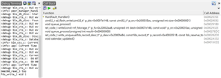

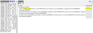

  • I had been using WRITE_SIZE 1024 from another suggestion on devzone, but still the same issue.
    The other bit of code merged was the Calendar example,
    and it seems the function nrf_cal_set_callback() is what seems to be causing the Assert.
    Without the callback(), the fds_record_write() is working ok.
    I checked the suggestion by Torbjørn (ovrebekk), to make sure RTC2 is being used, and it is.
    I merged sdk 15.3 CTS with Calendar and added the FDS write() to test on DK832 and reproduce the issue.
    The fault happens in fds_write_1() during fds_record_write(), line 248 on SES.
    (After connecting on nRF Connect, press button 1 on the DK).

    void print_current_time()
        printf("Epoch:\t%d\r\n", nrf_cal_get_epoch());
        printf("New time:\t%s\r\n", nrf_cal_get_time_string(false));
    /* set run_time_updates=false to stop calendar updates*/
    void calendar_updated()
        if(run_time_updates)
    //        print_current_time();
            fds_write_1();

        nrf_cal_set_time(year, month, day, hour, minute, second);
        /* function calendar_updated called every 5 seconds */
        nrf_cal_set_callback(calendar_updated, 5);

  • also, if fds_record_write() is commented, the calendar cycles properly as intended.
  • Hi Simon,
    It seems you forgot to initial the fds in the uploaded project. Please see nRF5 SDK v15.3.0: Usage and Flash Data Storage Example on how to initiate the FDS.
    -Amanda H.
