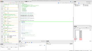

    I tried debugging into aws_iot_topics_populate to see where the failure is happening but for some reason the debugger won't step into the C function. Here's a screenshot of what I get:
    I thought the reason may be due to optimisations done by the compiler, so I tried the below setting in prj.conf:
    CONFIG_DEBUG_OPTIMIZATIONS=y
    but still couldn't step into the function. In fact, the code seems to crash... please see below:
    Any suggestions / pointers?

  • I can confirm that I see the crash when calling aws_topics_populate both with no optimizations and with debug optimizations. The call does not crash when optimizing for size or speed.
    I haven't yet found a good reason for why the crash happens, but I have informed the developers of that library.
    To me, it seems like aws_topics_populate is inlined in aws_iot_init when optimizing for speed or size. You can still step through the function, but it will look like you are inside the aws_iot_init function. This is exacerbated by the fact that aws_topics_populate is almost exclusively calls to snprintf, so most time would be spent there, rather than the few assembly instructions that "actually" come from aws_topics_populate.
    I can agree that it is not be best debugging experience, but other than the crash when not optimizing the code, I can not find anything wrong.
