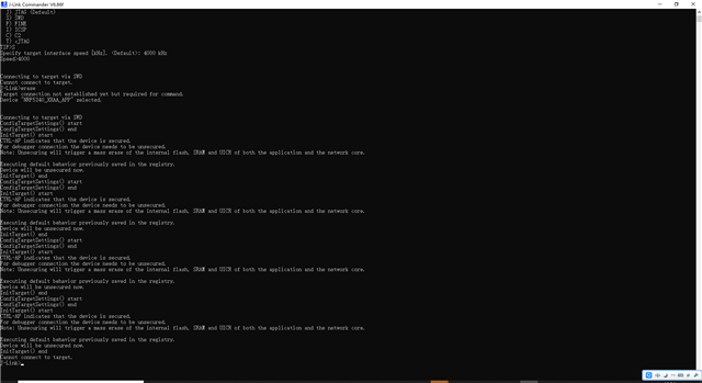

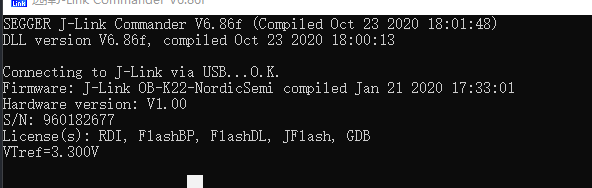

         I also try to open it with J-Link Commander, it can recognize ,like this:
       so I use 'erase' cmd(because I already tested on my nrf52840DK, it was worked), but on this nrf53DK, it failed:
    I'm not sure what wrong operations had done on this DK previously, but now it's still unprogrammable

  • Hi Smile,
    Thanks for the detailed logs.
    It seems that it isn't able to communicate with the nRF at all. No contact over DP, so I suspect that there might be a hardware issue here.
    Are any of the "nRF current measurement" solder bridges cut? Is the kit in any way modified?
