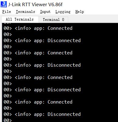

52833 LFRC cannot connect
I used LFRC ,but cannot be connect by nRF Connnect on iphone.
below is this case information:
DK is PCA10100
nRF5_SDK_17.0.2_d674dde
......ble_peripheral\ble_app_uart\pca10100\s113\ses
s113_nrf52_7.2.0_softdevice.hex
#define CLOCK_CONFIG_LF_SRC 0
#define NRFX_CLOCK_CONFIG_LF_SRC 0
#define NRF_SDH_CLOCK_LF_SRC 0
#define NRF_SDH_CLOCK_LF_RC_CTIV 16 //0
#define NRF_SDH_CLOCK_LF_RC_TEMP_CTIV 2 //0
#define NRF_SDH_CLOCK_LF_ACCURACY 1 //7
