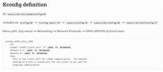

Zephyr version v1.14.1 had following definitions.
https://docs.zephyrproject.org/1.14.1/reference/kconfig/index.html
CONFIG_LWM2M_LOCAL_PORT
CONFIG_LWM2M_PEER_PORT
But in case of Zephyr version v2.3.0, Items Above couldn't be found.
https://docs.zephyrproject.org/2.3.0/reference/kconfig/index-all.html
It's found only CONFIG_LWM2M_PEER_PORT.
So To test this, they modified Kconfig file in folder in zephyr\subsys\net\lib\lwm2m.
The added texts below.
After above, Configurations of nRF connect SDK seems to be applied.
But Test result is not ok.
Could you check that CONFIG_LWM2M_LOCAL_PORT could be used on LWM2M project?

    First, when using NCS, you should use the NCS version of Zephyr's documentation, and not the upstream version.
    That way, you can be sure that you are seeing the correct version for the NCS version you are on. In addition, there might be some changes to the documentation to match the changes we have done downstream (though these should be minimal).
     The Kconfig options just end up as #defines. If the code doesn't use them, they don't do anything. If the option has been removed, the code that used the option has most likely also been removed, so simply adding the option back in will not do anything.
    But, you should be able to to add the functionality as well by finding the place where the socket is created, and bind()-ing it to a fixed port number.

  • In NCS v1.4.0, the socket is created in the lwm2m_socket_start function in zephyr/subsys/net/lib/lwm2m/lwm2m_engine.c.
    Once socket has been created, and stored in client_ctx->sock_fd, you can bind it to an address using bind().
    You can find the documentation for bind() here: https://pubs.opengroup.org/onlinepubs/9699919799/functions/bind.html
    James_Lee_K said:
    If CONFIG_LWM2M_ENGINE_DEFAULT_LIFETIME is  30 seconds and when LWM2M client notify observer, Local port isn't changed.
    But if CONFIG_LWM2M_ENGINE_DEFAULT_LIFETIME is setup to 34200 seconds, Local port is changed.
     This sounds like a NAT timeout in the network. In the networks we have tested, the network will delete the entry in the translation table after ~1 minute of inactivity for UDP traffic.
    But, we have also seen both shorter and longer timeouts.
