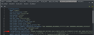

Another question again ^^. Why pin 9&10 of nRF52832 cannot invert like GPIO, their description is "NFC antenna connection" and "General purpose I/O", the default usage of them is NFC? How to change its purpose to GPIO?
see this link, you can add CONFIG_NFCT_PINS_AS_GPIOS at c_preprocessor_definitions.
