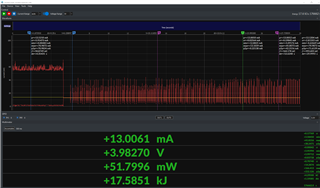

I am trying to measure the low power performance of the nrf9160.
For this, I tried to use the "system_off" example in the folder : C:\Users\adeel\ncs\v1.4.0\zephyr\samples\boards\nrf\system_off.
I am using a nrf9160DK v 0.9.0 and using Joulescope for my power measurement.

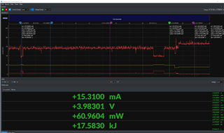

While running the program, I observe that the Active mode consumes 15.3 mA of current,

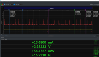

then reduces to 13.7 mA in sleep mode
and then finally to 13.0 in the deep sleep mode.
The current never reduces less than 13 mA which is quite strange. I did not expect any of these values so I wanted to know what could be wrong with this ?
I was expecting Active mode current to be around 2.3 mA, sleep mode to be around 700 uA and deep sleep around 30-40 uA.
