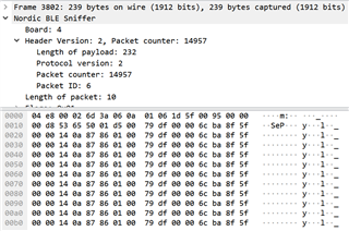

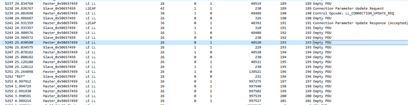

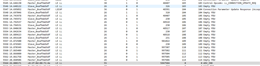

  • captured traces for the good (27/23), and the bad (251/247),
    and including debug log outputs for both.
    not sure what would be needed to make the 251/247 connection be handled properly,
    and not to disconnect early or even be able to bond like 27/23.
    thank-you,
    cts_bad-6.pcapng
    cts_good-5.pcapng

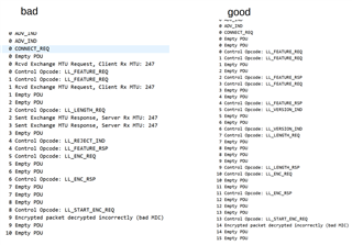

  • Hi Simon,
    Could you let me know more information about the phone ? Which brand name and phone name?
    From the trace I can find that the phone rejected the LL_LENGTH_REQ with LMP PDU Not Allowed. Most likely that it doesn't support data length extension (even though in the Feature list it does set this as true).
    Could you please try to test with ble_app_nus example and try to set the NRF_SDH_BLE_GAP_DATA_LENGTH  to 251 to see if you get the same issue. Please capture a sniffer trace of that as well (because it doesn't need bonding, so it's easier to debug). Please try to capture until the connection is terminated and the device advertise again.
    Please try to test with smaller NRF_SDH_BLE_GATT_MAX_MTU_SIZE  and NRF_SDH_BLE_GAP_DATA_LENGTH (smaller than 251 but bigger than 27)  just to check if it's the limit of the phone.

  • Hi Simon,
    Please try to capture another trace with Nexus 6p and 251 bytes data length. This time please try to capture when you bond with the device for the first time (you need to delete bond on the phone and the device). In the trace you send at the beginning the connection was not decrypted because the sniffer trace didn't capture the bonding process.
    Please also set SEC_PARAM_LESC = 0 so that LE Secure connection won't be used. The sniffer can't sniff a connection with LE Secure connection used.
    EDIT: In the new trace you sent with UART firmware, I also find the Nexus rejected the length request. Are you sure you can send long notification with the Nexus ? Please try to capture a sniffer trace with some (large) data exchange.
