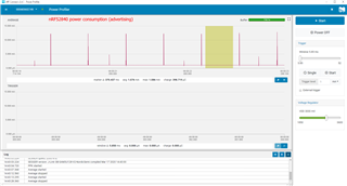

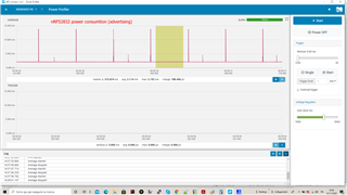

  • Hi Simon,
    thanks for your quick reply.
    I attached the PPK graph of both devices.
    Yes, we are quite positive that fw for the 2 devices has the same peripherals running.
    We thought the bacground consumption depended mostly by the UART enabled. But could be different in the 2 devices?
  • Are you seeing these different current consumption levels on development kits or are you testing on custom boards? If the latter is the case, I think I need some details on your hw configurations. Does, for example, one of the devices use the internal LFRC oscillator while the other one have an external crystal oscillator? Would it be possible to share the schematics of these custom boards? I can set this case to private mode if you'd like, so that only yourself and Nordic engineers will be able to see this case.
    Simon
