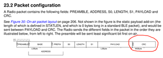

Since it is used to transmit voice coded data, can the retransmission mechanism in the protocol stack be turned off?
And whether the verification in the figure can be turned off, regardless of whether the data is successfully verified. The original data must be given to the application layer.
     No, not currently.
    Bluetooth is working on the Bluetooth Low Energy specification on Audio over BLE (which is not yet done, as far as I know).
    Using BLE as it is now (at least until the audio over BLE specification is decided and implemented) it is not possible to turn off retransmissions or CRC checks. This is the reason that headsets these days still use Bluetooth Classic.
