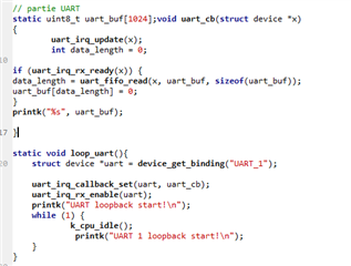

How to configue an external UART from nRF9160 dk ?
I use the app "asset-tracker", and i would like to configure an external uart to connect a sensor to the board.
I modifed the code but i can't detect any new COM from the device manager.
Here, what i made like modification :
in the nrf9160dk_nrf9160ns.dts file :
in the main.c file :
I think the problem comes from the file prj.conf, all modifications i made in it, crash the app ... so i don't know what to add ...
I hope someone can help me Slight smile
Best Regards
Zita

    so i added this in my kcong file :
    "config UART_1_NRF_UARTE
        bool
        default n
        select NRF_UARTE_PERIPHERAL
        depends on UART_NRFX && SERIAL
        help
          Enable nRF UART with EasyDMA on port 1."
    Did I understand right ?
    Now i have no problem to open and reload my project.
    UART1 isn't see like a port COM now, wich it is a good news but i see nothing in my external port by a terminal Putty. So did i miss something else ?
