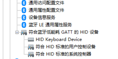

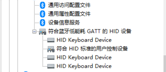

how to send all key value by hid keyboad?
   im use the example of   nRF5_SDK_16.0.0_98a08e2\examples\ble_peripheral\ble_app_hids_keyboard
and i change the code of static void hids_init(void) like this:
#define BUFF_LEN 28

    static uint8_t                     report_map_data[] =
			#if 1
        0x05, 0x01,                    /* USAGE_PAGE (Generic Desktop)                   */\
        0x09, 0x06,                    /* USAGE (Keyboard)                               */\
        0xa1, 0x01,                    /* COLLECTION (Application)                       */\
			  0x85, 0x01,
        0x05, 0x07,                    /*   USAGE_PAGE (Keyboard)                        */\
        0x19, 0xe0,                    /*   USAGE_MINIMUM (Keyboard LeftControl)         */\
        0x29, 0xe7,                    /*   USAGE_MAXIMUM (Keyboard Right GUI)           */\
        0x15, 0x00,                    /*   LOGICAL_MINIMUM (0)                          */\
        0x25, 0x01,                    /*   LOGICAL_MAXIMUM (1)                          */\
        0x75, 0x01,                    /*   REPORT_SIZE (1)                              */\
        0x95, 0x08,                    /*   REPORT_COUNT (8)                             */\
        0x81, 0x02,                    /*   INPUT (Data,Var,Abs)                         */\
        0x95, 0x01,                    /*   REPORT_COUNT (1)                             */\
        0x75, 0x08,                    /*   REPORT_SIZE (8)                              */\
        0x81, 0x03,                    /*   INPUT (Cnst,Var,Abs)                         */\
        0x95, 0x05,                    /*   REPORT_COUNT (5)                             */\
        0x05, 0x08,                    /*   USAGE_PAGE (LEDs)                            */\
        0x19, 0x01,                    /*   USAGE_MINIMUM (Num Lock)                     */\
        0x29, 0x05,                    /*   USAGE_MAXIMUM (Kana)                         */\
        0x91, 0x02,                    /*   OUTPUT (Data,Var,Abs)                        */\
        0x75, 0x03,                    /*   REPORT_SIZE (3)                              */\
        0x91, 0x03,                    /*   OUTPUT (Cnst,Var,Abs)                        */\
        0x95, BUFF_LEN*8,              /*   REPORT_COUNT (BUFF_LEN*8)                             */\
        0x19, 0x00,                    /*   USAGE_MINIMUM (Reserved (no event indicated))*/\
        0x29, 0x00+BUFF_LEN*8-1,       /*   USAGE_MAXIMUM (Keyboard Application)         */\
        0x81, 0x02,                    /*   INPUT (Data,Ary,Abs)                         */\
        0xc0,

    memset((void *)input_report_array, 0, 3*sizeof(ble_hids_inp_rep_init_t));
    memset((void *)output_report_array, 0, 1*sizeof(ble_hids_outp_rep_init_t));
    memset((void *)feature_report_array, 0, 1*sizeof(ble_hids_feature_rep_init_t));
    // Initialize HID Service
    p_input_report                      = &input_report_array[INPUT_REPORT_KEYS_INDEX];
    p_input_report->max_len             = INPUT_REPORT_KEYS_MAX_LEN;
    p_input_report->rep_ref.report_id   = 1;//INPUT_REP_REF_ID;
    p_input_report->rep_ref.report_type = BLE_HIDS_REP_TYPE_INPUT;
    p_input_report->sec.cccd_wr = SEC_JUST_WORKS;
    p_input_report->sec.wr      = SEC_JUST_WORKS;
    p_input_report->sec.rd      = SEC_JUST_WORKS;
    p_input_report                      = &input_report_array[1];
    p_input_report->max_len             = 4;
    p_input_report->rep_ref.report_id   = 2;
    p_input_report                      = &input_report_array[2];
    p_input_report->max_len             = 7;
    p_input_report->rep_ref.report_id   = 3;
    p_output_report                      = &output_report_array[OUTPUT_REPORT_INDEX];
    p_output_report->max_len             = OUTPUT_REPORT_MAX_LEN;
    p_output_report->rep_ref.report_id   = OUTPUT_REP_REF_ID;
    p_output_report->rep_ref.report_type = BLE_HIDS_REP_TYPE_OUTPUT;
    p_output_report->sec.wr = SEC_JUST_WORKS;
    p_output_report->sec.rd = SEC_JUST_WORKS;
    p_feature_report                      = &feature_report_array[FEATURE_REPORT_INDEX];
    p_feature_report->max_len             = FEATURE_REPORT_MAX_LEN;
    p_feature_report->rep_ref.report_id   = FEATURE_REP_REF_ID;
    p_feature_report->rep_ref.report_type = BLE_HIDS_REP_TYPE_FEATURE;
    p_feature_report->sec.rd              = SEC_JUST_WORKS;
    p_feature_report->sec.wr              = SEC_JUST_WORKS;
    hid_info_flags = HID_INFO_FLAG_REMOTE_WAKE_MSK | HID_INFO_FLAG_NORMALLY_CONNECTABLE_MSK;
    memset(&hids_init_obj, 0, sizeof(hids_init_obj));
    hids_init_obj.evt_handler                    = on_hids_evt;
    hids_init_obj.error_handler                  = service_error_handler;
    hids_init_obj.is_kb                          = true;
    hids_init_obj.is_mouse                       = false;
    hids_init_obj.inp_rep_count                  = 3;
    hids_init_obj.p_inp_rep_array                = input_report_array;
    hids_init_obj.outp_rep_count                 = 1;
    hids_init_obj.p_outp_rep_array               = output_report_array;
    hids_init_obj.feature_rep_count              = 1;
    hids_init_obj.p_feature_rep_array            = feature_report_array;
    hids_init_obj.rep_map.data_len               = sizeof(report_map_data);
    hids_init_obj.rep_map.p_data                 = report_map_data;
    hids_init_obj.hid_information.bcd_hid        = BASE_USB_HID_SPEC_VERSION;
    hids_init_obj.hid_information.b_country_code = 0;
    hids_init_obj.hid_information.flags          = hid_info_flags;
    hids_init_obj.included_services_count        = 0;
    hids_init_obj.p_included_services_array      = NULL;
    hids_init_obj.rep_map.rd_sec         = SEC_JUST_WORKS;
    hids_init_obj.hid_information.rd_sec = SEC_JUST_WORKS;

and the hid info  of other businesses' s 52810 keyboardlike this:
and my keyboard's hid info like this:
obviously,there is only one HID Keyboard Device in my keyboard ,and the other businesses's keyboard is 3,
2.so i want to konw how to add the HID Keyboard Device ?
