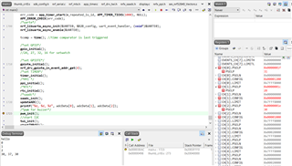

  • Thanks for your response. I try to change yp to 6 which is AIN2, but it still jump to the hardfault handler. after initialize the channel Also, in another project, I am using pin 28, 30 and 31 as the positive input and you can see from the picture, the register can set properly and I can get the sample value.
    By the way, could you please tell me what will cause the hard fault issue?
    Thanks very much for your help:)

  • Thanks for your reply. I extract the saadc part from my project. The terminal output and the register setting are the same as the pictures before. It should print three sample values in the terminal. Please have a try.
    Thanks a lot.

  • I'll try to set it up on my end.
    Have you disabled ASSERTs for that project? What SDK are you using for these two projects?
    All instances of the nrf_drv_saadc_channel_init in the nRF5 SDK 12.3 and upwards contain the following check:
    ASSERT((p_config->pin_p <= NRF_SAADC_INPUT_VDD) &&(p_config->pin_p > NRF_SAADC_INPUT_DISABLED));
    Where NRF_SAADC_INPUT_VDD = 0x9 and NRF_SAADC_INPUT_DISABLED = 0x0.
