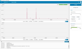

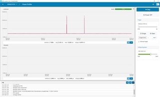

  • Hello Jared,
    Thank you for your response. After checking my devkit current consumption through power profiler, I found out that it actually quite stable at 7.5 uA when uart disabled, and 2.1mA when uart is enabled.UART enabledUART disabled
    I also found out that using these would actually increase current consumption by 1.5uA on my devkit (or might be only due to some variance).
