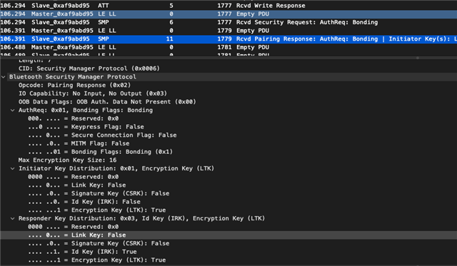

For debugging I used the nRF Connect for Mobile application and there I am able to bond/pair to the device successfully with my android and do whatever I want, I am also able to sniff this communication process using wireshark and nRF52 board that I have.
First the request from nRF Connect in my android device to "bond"
And here is the response from BPM
BUT when I do the pairing process with my raspberry pi 4 (And the nRF52) the connection fails with an "Unspecified Reason"
The Response from the BPM

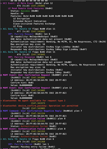

I used sudo btmon to monitor the behavior inside the Raspberry Pi
> ACL Data RX: Handle 64 flags 0x02 dlen 6                                                         #17 [hci0] 26.323537
      SMP: Security Request (0x0b) len 1
        Authentication requirement: Bonding, No MITM, Legacy, No Keypresses (0x01)
< ACL Data TX: Handle 64 flags 0x00 dlen 11                                                        #18 [hci0] 26.323661
      SMP: Pairing Request (0x01) len 6
        IO capability: NoInputNoOutput (0x03)
        OOB data: Authentication data not present (0x00)
        Max encryption key size: 16
        Initiator key distribution: EncKey Sign (0x05)
        Responder key distribution: EncKey IdKey Sign (0x07)
> HCI Event: Number of Completed Packets (0x13) plen 5                                             #19 [hci0] 26.371976
        Num handles: 1
        Handle: 64
        Count: 2
> ACL Data RX: Handle 64 flags 0x02 dlen 6                                                         #20 [hci0] 26.420475
      SMP: Pairing Failed (0x05) len 1
        Reason: Unspecified reason (0x08)
I also tested to pair with the GUI tool and gatttool, no success.

I also tried to reproduce the same requirements as the android appears to share with the BPM in terms of:
- IO Capability: Keyboard, Display (0x04)
- AuthReq: 0x05, MITM Flag, Boding Flags: Bonding
This with always a pairing failed response...

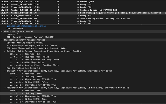

    - using gatttool, security-level = low, cleared BPM paired data, BPM in pairing mode (hold down bluetooth button) -> can connect, read device info etc.  But when I try to read BPM data it fails with "Passkey entry failed".  This is what is seen sniffing the BPM:
    and this is what btmon reads on the pi:
    - Now same thing but with security-level= medium -> btmon shows the pi connected but then pairing failed with same reason

    - can connect but when trying to pair with params [No keyboard/no display, no secure connection, no MITM, no OOB, no keypress, bonding yes] I receive this error
    15:35:43.967	Error when calling replySecParams: Error: Error occured when replying sec params. Errorcode: Unknown value (0x8005)
    15:35:43.970	Received status with code 4 Unknown value, message: 'Error sending packet to target. Code: 0x802a'
    Additionally is there reference code for the nrf52dk for connecting and pairing to a peripheral, so that I can mess with security params and don't have to start from scratch?
    I believe I just need to set the security parameters properly as the models I have are supposed to be able to pair without a pin, but unsure how to do so.  I believe it is Bonding, no SC, no MITM, no OOB.
