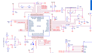

   I have done customized board using nRF52832 and when I try to flash code using nRF52 DK(Jtag). I can able to control led's using customized board. But Bluetooth is not showing in nordic app. BLE part alone not working. Proper matching circuitry is made. Earlier we did one customized board with same connection. That was working. But same schematic another board BLE part is not working.Please suggest us regarding. And there is no voltage and placement issue Awaiting for response.Thanks.

  • If you really can exclude broken or wrong hardware components on your custom board I'd recomment to double check if your board fits the mode you are using in your Firmware (DCDC or LDO), you've used and flashed the correct softdevice and your sdk_config.h does not make assignments which are not matching your custom board.
    Otherwise I'd make use of Nordics schematic/layour review service to check if your custom board meets the design requirements.
