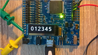

  • Here is a working solution where the whole area is in use. The result is some characters shown on the display.
    The sample code is attached:
    cfb-ncs150-oled-128x32-91dk-17-03-21.zip
    Setup:
    nRF Connect SDK: v1.5.0.
    DK: nRF9160 DK v1.0.0 (I have also had success with DK v0.9.0).
    OLED: Noname 4-pin 128x32 with SSD1306 display driver.
    The display is connected to the DK like this:
    SDA - P0.30
    SCL - P0.31
    VCC - 5V-pin on the side of the DK
    GND - GND on DK
    This is shown In the image at the top(yellow and red are connected, green and black are connected).

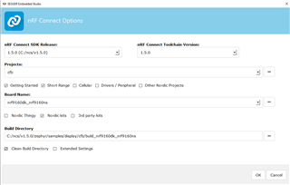

    5. Then open nRF Connect v3.6.1 -> Toolchain Manager -> 'Open IDE' next to nRF Connect SDK v1.5.0. and SES opens.
    6. In SES, clikc File -> Open nRF Connect SDK Project...
    7. Select your project folder. Under Board Name, select 'nrf9160dk_nrf9160ns',  check 'Clean Build Directory'.
    8. Build -> Build and Run.
    The display should now output the characters '012345'. The image is flashing rapidly, I am working on how to solve this.
