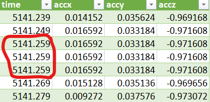

I'm using the following code to communicate my NRF52-DK with pc.
But sometimes the DK transmitting repeat data and sometimes error data is sent(missing 1 byte).
Especially when two peripherals connected.
Can somebody assist me?

  • sometimes the DK transmitting repeat data and sometimes error data is sent(missing 1 byte).
    How do you know that the problems are in the DK ... ?
  • Because the problems is getting worse when two peripherals connected.
    1 peripheral:
    total time 117.73
    total packet 11774
    repeated packet 2
    CRC erorr 0
    2 peripherals,
    p1 p2
    total time 53.9 53.58
    total packet 5393 3528
    repeated packet 137 862
    CRC erorr -3 1830
    Receiving side is a PC running Python. It keeps checking inWaiting() and printing out the value.
    I don't think my pc is slower than a DK...

  • Adding additional BLE peripheral links are in essence just more high priority interrupts that cause more frequent pending of code execution in the application main() and interrupts. I am not sure where to begin to debug here, but adding a counter in the buffer, could make it easier to catch that the same nrf_libuarte_async_tx() was called two times with the same counter. That could be a start to narrow it down?
  • Thank you so much for the suggestions.
    The problem actually related to the event length.
    Hope this code helps the people with similar questions.
