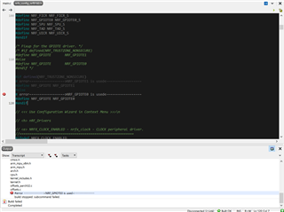

    In order to use GPIOTE in a nonsecure application, you have to use GPIOTE1, and not GPIOTE0. Check out nRF9160 GPIOTE Register in the infocenter Thus, NRF_GPIOTE should get mapped to NRF_GPIOTE1. Could you test one thing?
    Could you modify these lines in the following manner:
    #if defined(NRF_TRUSTZONE_NONSECURE)
    # error ------------------>NRF_GPIOTE1 is used<------------------
    #define NRF_GPIOTE       NRF_GPIOTE1
    #else
    # error ------------------>NRF_GPIOTE0 is used<------------------
    #define NRF_GPIOTE       NRF_GPIOTE0
    Then rebuild and see what message is printed. I you're using SES, you could also open ncs\v1.4.0\modules\hal\nordic\nrfx\drivers\src\nrfx_gpiote.c and click on the definition of NRF_GPIOTE.

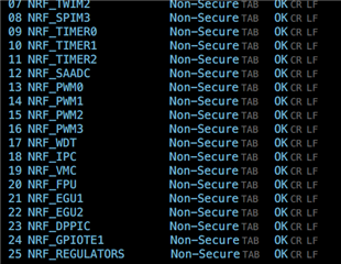

    Could you also check if NRF_GPIOTE1 is correctly configure to the nonsecure domain by SPM? that is done by checking the log that shows up before the main application. The line "24 NRF_GPIOTE1        Non-Secure OK"  should get printed:
    *** Booting Zephyr OS build v2.4.0-ncs1 ***
    Flash regions Domain Permissions
    SPM: prepare to jump to Non-Secure image.

    Following your instructions, I modified the lines here and got following response when building:
    Also, I can see "24 NRF_GPIOTE1        Non-Secure OK"
    So, what should I change to make that sample work using GPIOTE1? Thank you.
