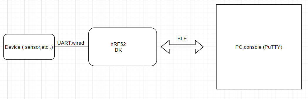

Establishing serial communication between NRF52832 DK and PC through BLE
i am begginer, using my nRF52832 DK with ble_app_uart as peripherial, which is connected to PC via J-link (usb cable). I want is to establish serial communication between nF52832 DK and PC via BLE (using virtual COM port and program like PuTTY), using Asus BT400 usb ble dongle (bluetooth 4.0). When I add RF52832 DK on PC, LED 1 stops blinking and start to indicate connection for few seconds (just ligths), then it returns to blinking. Monitoring traffic with Wireshark ( attached in code, line 34) , i noticed line that says: Rcv Pairing Failed: Pairing not supported.
When establishing serial connection to my android phone, everything works fine and without problem.
I have following questions:
1.)  What thing do i need to add to my code, to establish connection to PC?
2.) I tried ble_app_hids_mouse example, which establish permanent connection with PC withoust problem, is that becouse nRF52832 DK is introduced to PC as HID?
3.) I there possibility anything to be wrong with my drivers ( do I need any special driver), or am i missing something else?
Thanks for answer & best reagards,
Kristof

  • CSRK is not supported by our softdevice (BLE stack).
    You need to check why ASUS BT400 is sending you a pairing quest with CSRK bit set. The Nordic BLE Stack will reject that pairing request immediately. I think that is the main issue you are seeing here.
  • Hi, thanks for quick answer.
    I sniffed communication bertween nRF52832 DK (with ble_app_hids_mouse exaple on) and PC (ASUS BT400), and there is also pairing request with CSRK bit ( attached code, line 12 and 13).
    Is it possible that the probem is that ble_app_uart example doesnt include peer menager?
    How could i set BT400 not to send pairing request with CSRK? I am browsing through windows setting and cant find anything useful?
    Thanks& best reagards,
    Kristof

    Another question:
    In my final application, I want to send and recive data from PC ( with terminal like putty, virtual COM port) to custom PCB.
    PCB(custom device) <- uart connection -> nRF52DK <- BLE -> PC terminal
    When I estabilsh BLE connection between PC and nRF52DK (with peer manager and Nordic Uart Service), how do I open virtual COM port on PC? Will I have any trouble becouse NUS is unknown service to PC?
    Kristof
