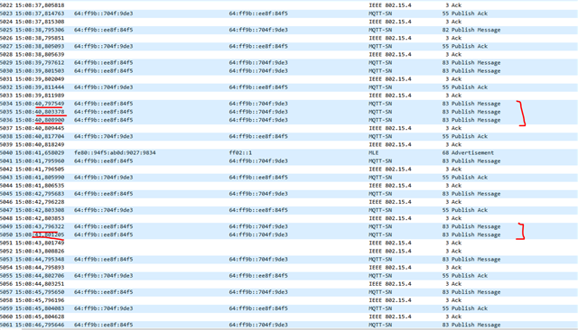

  • UPDATE:
    Using Wireshark I noticed there are multiple publish of the same message: these are not retransmissions due to the timeout (MQTTSN_DEFAULT_RETRANSMISSION_TIME_IN_MS) which is set to 5000ms.
    These additional messages have the same payload and are sent with a time delta of a few milliseconds. Also, only one ACK is sent back for a set of multiple messages..
    The network only have two nodes (Border Router and a Dongle that publishes messages).
    Can you tell what these additional messages are?
    Thanks!
  • There are different layers of ACKing. As you can see there is a default network Ack, and a Publish Ack. The difference is that the Publish Ack is from a different layer in the stack, and I don't think it is possible to disable this.
    If you would have had 3 nodes, A, B and C. Let us say that A sends a message to C, and the routing is via B. The message requires an application Ack.
    If everything works as intended, then A will send the message to B, and B will Ack it. Then B will send it to C and C will Ack it. Then C will send a Publish Ack back to A. It will start by sending this from C to B, and B will Ack that message. Then B will forward that message to A, and A would Ack it.
    If at any point a packet is dropped, it would be retransmitted, as long as it doesn't pick up the Ack. However, if the message is lost between B and C, then A would wait for 5000ms, and if it didn't receive the Publish Ack before that, it would retransmit the original message to C (via B).
    Hopefully, that didn't confuse more than it explained.
    Edvin
