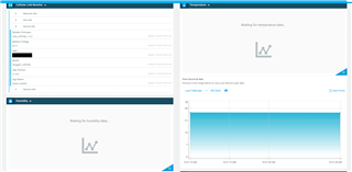

Hi Miroslav,
Can you provide a view of the log output in nrf Cloud?
And can you provide a log file from LTE Link monitor that shows data sendt ?
The device info is retrieved from the shadow and not updated every time the device connects.
Jonathan
Problem was with the nRF Cloud account. It was probably created long time ago and something went wrong. With the new account everything works as it should.
