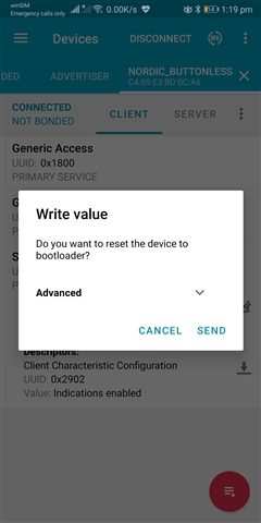

  • Hi Mr. Bui,
    Thanks for the information. Now, I got full clarity on how it is working and I could be able to successfully test the buttonless DFU example. I want to implement the same functionality into a template application. So here are my doubts.
    When I connect to the Nordic_Buttonless in nRF connect for android, I could see the "Secure DFU service" as shown in image 1 with characteristic "Buttonless DFU".
    When I click on the characteristic "Buttonless DFU" it is giving the option to launch the bootloader and just launching the bootloader when yes is given. On the other hand when I click the DFU symbol present on top right corner it is asking to select the firmware zip package and when selected the zip package, it is automatically launching the booltoader and connecting to the bootloader and updating the application. Now, I want to know below things.
    1) Which file is responsible for adding the DFU service and Buttonless dfu characteristic to it (I believe it is nrf_dfu_ble.c) ?
    2) When we send the characteristic to lanuch into bootloader mode, we will write the magic value to the retention register (GPREGRET) and do the soft reset. So, in which file we are doing this process ?
    3) How can I just add the buttonless DFU characteristic without the DFU symbol on top right corner ?
    Thanks in advance for your help.
    Regards
    Rahul Chowdary
  • Hi Rahul,
    1. Please have a look inside ble_app_buttonless project. The service is declared in ble_dfu.c (ble_dfu_buttonless_init()) , depends on if you do DFU with or without bond you would need ble_dfu_bonded.c or ble_dfu_unbonded.c
    2. It's inside ble_dfu_buttonless_bootloader_start_finalize() we don't reset immediately but gracefully disconnect before we reset.
    3. Its the nRF Connect feature to support DFU buttonless. Are you planning to build your own app/DFU app? You can refer to the DFU profile inside nRF Toolbox. The nRF Connect is not really you should send to the end customer. It's a debug tool.
