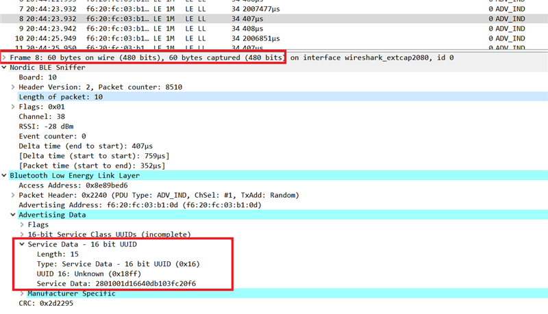

I also captured this data using Wireshark and the provided Nordic BLE sniffer firmware. The ServiceData can be seen in the lower red box below. Also note that there are "60 bytes on wire" which I will get to in a second.

2. Wireshark says the advertising packet is 60 bytes. Does this mean that it's actually 60 bytes or is this Wireshark combining the advertising data into a single packet for viewing purposes? I thought the advertising packet length was limited to 31 bytes if not using advertising extension?

    2: The 60 bytes refers to the entire frame received by wireshark, which includes the serial data from the sniffer (advertising address and more). The advertising data is maximum 31 bytes. The nRF Sniffer does not combine the advertisement and scan response.
