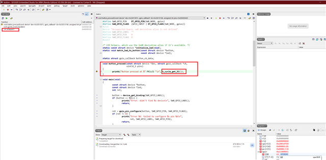

We want to measure the pulse width that enters a digital input of the nrf9160. After the above, we will publish it on a server with MQTT.
We hope that the sources of the tick or method that you suggest allow us to keep the low current consumption of the SoC.
Here are our questions:
    1) What method should we use to obtain the ticks within a digital input ISR?
    2) Is the clock source for that tick available during low power states?
    3) What is the resolution that we can expect with this method?
Basically, we want to know the best way that the Nordic team recommends to implement and get the time source mentioned in this Nordic post.
And preserve the low power consumption. And if it is possible with the lowest latency possible.
