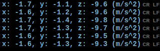

 - See attached a typical sequence of measurments when running the adxl362 sample included with zephyr. The z axis is measuring earths gravitation, but why the other two axis are consistently measuring values around -1.5 m/s^2? This is of course with the device motionless. Does the accel need to be calibrated somehow?
