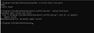

  • Py launcher does seem to be a problem:
    (env) C:\Program Files\Wireshark\extcap>py -3
    Python 3.6.0 (v3.6.0:41df79263a11, Dec 23 2016, 08:06:12) [MSC v.1900 64 bit (AMD64)] on win32
    Type "help", "copyright", "credits" or "license" for more information.
    >>> import serial
      File "<stdin>", line 1, in <module>
    ModuleNotFoundError: No module named 'serial'
    >>> exit()
    (env) C:\Program Files\Wireshark\extcap>python
    >>> import serial
    >>> exit()
