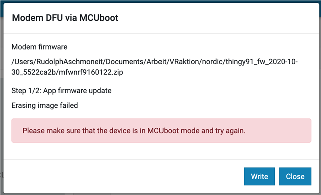

But this is not the point of my post, I tried to update the modem firmware of the thingy:91 and ran in a problem others mention here in devzone before, the Update fails with the following message:
I have pressed SW3 and then switched on the Thingy:91, at the first try(s) I only pressed SW3 until the device was available in the nRF Connect Programmer, later on I pressed it during the whole upgrade process, both failed. Also the Enable MCUboot was checked all the time.

2020-12-08T13:57:06.730Z INFO Modem DFU starts to write...
2020-12-08T13:57:06.731Z INFO Writing /Users/RudolphAschmoneit/Documents/Arbeit/VRaktion/nordic/thingy91_fw_2020-10-30_5522ca2b/mfwnrf9160122.zip to device
2020-12-08T13:57:19.194Z ERROR MCUboot DFU failed. Please make sure that the device is in MCUboot mode and try again.

    First, are you powering the Thingy:91 on and off with the power switch, and not just by connecting and removing the USB cable?
    When you power on the Thingy, are you pressing SW3 (the big button)?
    If the nRF9160 is in MCUBoot mode, the LED will not light up (while it should light up when not in MCUBoot mode).
    If you have been doing that correctly, you can try to update the firmware on the nRF52840.
    To set the nRF52840 in MCUBoot mode, you must press SW4, the small white button next to the nRF9160, while powering on the Thingy:91.

  • Hey Didrik, thanks for you reply,
    yes I am/was powering the Thingy:91 on and off using the power Switch, the USB cable is connected all the time.
    yes I am/was pressing the SW3 when powering the Thingy:91
    yes the LED lights not up when I am pressing SW3 and then powering on, she is ligthing up when the Error in the Programmer It lights up only at the moment when during the modem update process the error message appears in the programmer. (If I dont press the SW3 switch and powering on the Thingy:91 the LED lights up directly after the powering on.

    You can find the firmware for the nRF52840 together with the firmware for the nRF9160 on the Thingy:91 page: https://www.nordicsemi.com/Software-and-tools/Prototyping-platforms/Nordic-Thingy-91/Download#infotabs
    In the thingy91_fw_2020-10-30_5522ca2b folder, you should use the images in img_fota_dfu_hex when using MCUBoot through the Programmer application.
    For the nRF52840, you should use the thingy91_nrf52_connectivity_bridge_<date_and_hash>.hex file, though the thingy91_nrf52_usb_uart_bridge_*.hex file should also work.

     It sounds to me like you did everything correctly.
    Did the Programmer leave any log files?
    You can find where they are stored by opening the current log (see picture), and selecting "save as". You should then get a file browser window opened at the location where the logs are stored by default (at least on Windows).
    In Windows, the location is C:\Users\<user>\AppData\Roaming\nrfconnect\pc-nrfconnect-programmer\logs.
