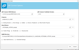

NRF5340 cannot use Project: peripheral_HR_coded
HI,
I tried to test all projects, but I ran into a problem,project create like this
I just downloaded the routine and didn't change anything, but I cannot create advertiser
this is UART output
I don't know what's wrong, and I can't find the meaning of err code

    I think that the issue could be that Segger Embedded Studio does not flash the child image, hci_rpmsg, to the network core on the nRF5340. If you build using west, then this should be done automatically starting from NCS v.1.4.0. The hci_rpmsg image should be located in your_build_folder\hci_rpmsg\zephyr
    You could try to flash it manually, using nrfjprog. e.g. from inside the build folder:
    nrfjprog --program hci_rpmsg\zephyr\zephyr.hex --sectorerase --coprocessor CP_NETWORK
    or using the Programmer app in nRF Connect for Desktop.
