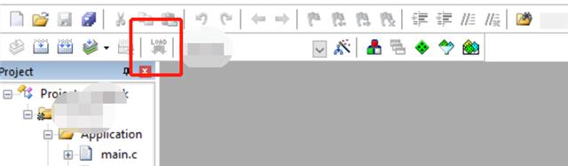

Refer to the website links you provided , I added DFU function to my project ,it works .I could upgrade my firmware upon nrf-connect app.
There is another question :
When I directly programed firmware to my borad by MDK-arm, the ble name changed to "DFU-TARG",it seems startup with "bootloader" mode.
How to fix it ?
Thanks a lot.

Sorry, I mean: just press this button "load"
did not work.
