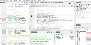

    Thanks to the link you gave me for the memory settings I moved successfully couple steps further, but still hitting the wall with exception and unfortunately still only migrating S112 to S113 on the same hardware PCA10040 / nRF52832 Frowning2
    So the problem I score to trace so far starts from line 219 of ss_clock.c  that is actually modified version of
    https://github.com/NordicPlayground/nrf5-calendar-example with major modification as: Added soft device, changed NRF_RTC2 as source, and there is FreeRTOS added. With S112 the code works Ok, with S113  line219 NRF_CLOCK->EVENTS_HFCLKSTARTED = 0; is the line where starts problems – never can reach the breakpoint on the next line 220.

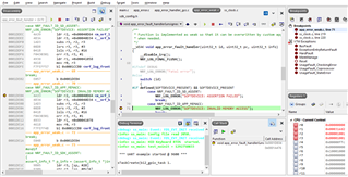

    So after hit Go/F5 while at breakpoint @ 219, SES send me to a place which is shown on screenshot Step2.png,

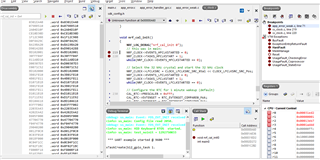

    then hitting again Go/F5 SES moves me to what is seen on Step3.png

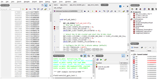

    and then next Go/F5 lead me to the breakpoint at line that prints the error message (Step4.png).
    Any idea where is the problem or at least how could trace it, because what is shown   Step2.png and Step3.png doesn’t give me any clue, even why SES debugger stops there without breakpoint?
    Thank you and best regards
    I do not see enough of your code to get a full context. However, I see you are modifying clock registers directly, and that is not allowed when the SoftDevice is enabled. So it is expected that you get NRF_FAULT_ID_APP_MEMACC when doing NRF_CLOCK->EVENTS_HFCLKSTARTED = 0;. I suggest you use the clock driver instead. Alternatively you could call sd_clock_hfclk_request() if there are no libraries that use the clock driver. This should also fail with S112, though.
