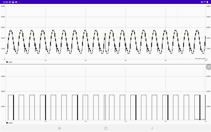

    Currently, the acquisition time is configured to 3us and the sampling event is triggered at every 10us by a timer.
    Here are some images of the sampled signals:

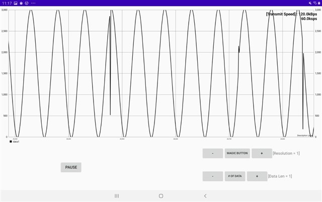

    50Hz sine wave:

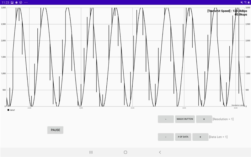

    1Khz sine wave:

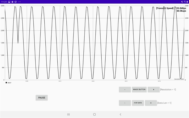

    5kHz sine wave:

  • The outlier-samples seems to happen quite regularly. Does these correspond to the start/end of the SAADC buffers or something similar?
    Are you running offset calibration in your application? If you are, you should make sure to follow this errata.
    Can you post your full project/code for us to reproduce this behavior?
