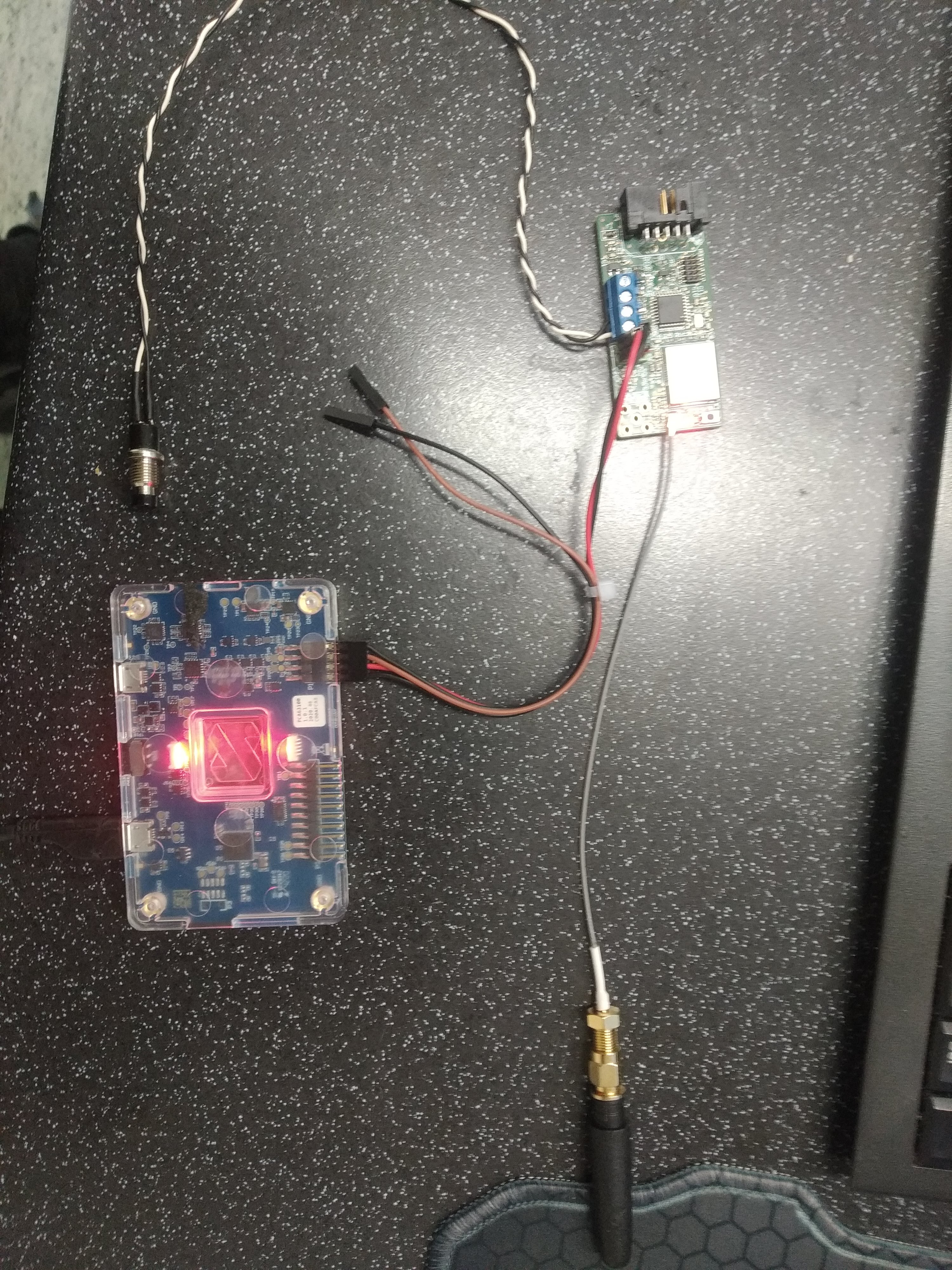

I just bought the new PPK2 tool which I think is awesome. However I think there are some issues with it.
Issue 1:
First of all thy X axis scaling is wrong by a factor of 6, that is the time measurements performed/showed in the PPK2 Power Profiler tool reports timing to be 6 times shorter than real life. See attached pictures. The "Power profiler snaphot" file is a snapshot of the current consumption of 869 Mhz transmitter in active transmitting state. As can be seen the selected area is reported to be ~60 ms. However taking the measurement with an oscilloscope (voltage drop over a 5 ohm series resistor) it is reported to be ~370 ms (time between the cursors in the "oscilloscope snaphot" file). Are these observations correct? I also noticed that when the X scale is set to a span of 3 sec I would expect a current change to take 3 sec to travel from right to left when live view is turned on. However it takes 18 sec. Am I missing something here?
Issue 2:
Again looking at the Power profiler snaphot" file, in the selected area there are a lot of measurement points reporting almost 0 uA current drawn by the DUT, but in the "oscilloscope snapshot" file, it doesn't reveal that (which is correct). Is this due to auto-scaling of the measurement circuitry within the PKK2 tool? At other points the PKK2 tool reports up to 27 mA but the DUT only consumes ~5 mA in theses states, I guess this is the same issue just sort of reversed (or could it by RF from my 10mW transmitter entering the sensitive measurement circuitry in the PKK2?)
Can you confirm there are issues with the tool or do I have a faulty unit?

  • My problems also persist. Measurement with PPK2 is full of noisy signal, see. previous pictures. In source meter mode, the signal is the worst. In ampere meter mode with battery source, the measurement is almost good. I think the problem is in hardware power supply filtering and usb power filtering. I still haven't been able to test the device on a laptop powered by an internal battery. If the problem isn´t be solved, then for me PPK2 isn´t usable for measuring IOT devices compared with PPK1.
    Regards
    Peter
  • , can you please register a new ticket, as the issues you have do not seem related to what is seeing.
    Please provide images with time stamps, and include the sidebar showing SMU voltage and other settings. Our PPK team are concerned about the antenna close to the PPK2 cables as well, are you able to increase the distance between (move the antenna further away)?
    With regards to the PPK1 vs PPK2 results, the PPK1 did have more noise reduction and averaging on the signal, and a lower frequency range compared to the PPK2.
