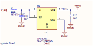

I developing a product that is currently in the pre-production stage, and im having some issues with voltage drops.
This si the regulator.Regulator.

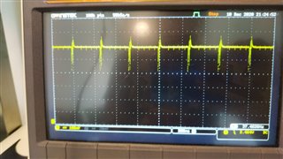

When im the bluetooth is connected and sending data, i see this in the DVDD line.

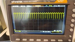

Each voltaje drop occurs with 20ms delay. And when i disconnet the bluetooth, and the NRF starts Advertising. i see this:
The firmware has a advertising of 265ms, and as you can see the voltaje drops occurs at aprox 270ms each. so i guess that it seems that the regulator cannot supply the current required.
Can someone Advice what should i do? change Capacitor for bigger ones? Another LDO?
