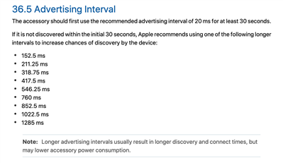

    It sounds like maybe what is happening here is that when the phone is streaming audio over Bluetooth, there is less time to do scanning. And then most likely, the advertising events of the peripheral does not overlap with the scan window of the phone.
    It is possible to do as you suggest, but we usually recommend to follow Apple's recommendations here, which typically work well also with other devices. Their recommendation is specified in section 36.5 in Accessory Design Guidelines for Apple Devices R13. Specifically:
    What apple suggests here is supported by the advertising module, which typically starts of first with fast advertising, and then after a specified amount of time enters slow advertising.
    The method you suggest, by using bursts of fast advertising, then waiting and doing bursts again is not explicitly supported by the advertising module. However, there is nothing preventing you from implementing it by simply configuring fast advertising, and then stoping and starting advertising regularly. Assuming you use the advertising module you configure and start it as normal, then stop it by calling sd_ble_gap_adv_stop(). Then after a designated time start advertising again by calling ble_advertising_start().

    Reading the case again I recall you only see this issue on some phones, and only when they also have BLE audio connection active. This would lead to less time to do scanning, so I suspect that is the problem here. Either the phone does not scan at all, or the scan window is short and occurs quite celdom, or it just co-varies in an unfortunate way with the advertising interval on the nRF. If that is the case, the only thing you can do is to reduce the advertising interval and see if that helps. As mentioned you should also pick an interval that is in line with Apple's recommendations, which also typically work well with Android devices.
