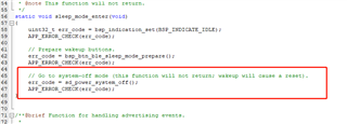

Any other kinds of sleep mode can be used ? I don't want wake up to reset MCU.
You can use CPU sleep for power saving mode instead of using System-Off. This is for instance done in the Power Profiling Application, which demonstrates how both modes can be used. When using CPU sleep, the application uses the sd_app_evt_wait function, which places the chip in 'Low Power' mode, and the chip will wake up on application interrupts. I would recommend checking out how this is done in the Power Profiling application, as well as reading the documentation for sd_app_evt_wait that I linked.
Marte
You mean just dummy this function "sleep_mode_enter()",
just use the "idle_state_handle()" function which could be found in the main loop?

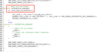

Another question ,
,should I define the SOFTDEVICE_PRESENT?
There are Ble_uart ,ble_blood_pressure,ble_device_imformation,ble_dfu funcitons in my project at present.
