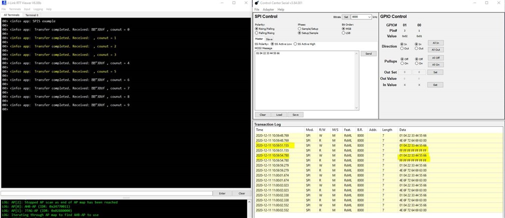

Hi Guys
Currently I start to merge SPIS driver in ble_app_uart project and have something want to consult with you.
Attached main.c file is what I’m testing.
Based on this code. I notice there have chance that RX buffer will be empty. As the yellow line which I drawn in below picture. (count 1, 2, 3, 5)
If I send SPI command continually, RX buffer can get data correctly (count 6,7,8,9). But if i wait a couple of time (>1s) and send SPI command again. RX buffer has the chance  will be be empty (count 1, 2, 3, 5)
May I have you help and give advice to me regarding this issue.  Thanks
void spis_event_handler(nrf_drv_spis_event_t event)
    static int count = 0;
    if (event.evt_type == NRF_DRV_SPIS_XFER_DONE)
        spis_xfer_done = true;
        NRF_LOG_INFO(" Transfer completed. Received: %s , counut = %d",(uint32_t)m_rx_buf, count);
        count++;
