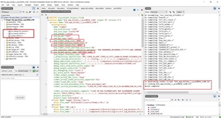

             Does NRF52810/NRF52811 support BLE_Central role with "S122" and "nRF5_SDK_17.0.2_d674dde"?

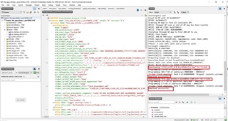

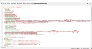

I try to convert example "\nRF5_SDK_17.0.2_d674dde\examples\ble_central\ble_app_blinky_c\pca10056" for running on NRF52811.
+ Win10 Os
+ Segger embedded studio for Arm 4.52C
Everything set up i thing it ok and build done follow link:
https://infocenter.nordicsemi.com/index.jsp?topic=%2Fsdk_nrf5_v17.0.2%2Fnrf52811_user_guide.html&cp=7_1_5_1_3&anchor=ug_52811_project
Bellow are picture in setting and building my example. Could you help me to see and let me know if it has any problem in case NRF52810/NRF52811 support BLE_Central role.
-->>Does NRF52810/NRF52811 support BLE_Central role with "S122" and "nRF5_SDK_17.0.2_d674dde"?
-->>in case NRF52810/NRF52811 support BLE_Central role, do you have recommend my setting.
Sory if my question so silly

    I mean when flash your code i dont see anything happened with indicate LED on my central board.
    I check with BLE blinky client, i also didnt see any happened with client. It mean not connecting with client.
    BLE central dont Adv so i only add some code using LED indicator to catch event. But nothing happened.
    Do you have any method to sniff to know central role active?
    My code modify on PCA100056 now running. So i try to change code to understand method central role working.
