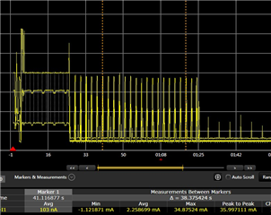

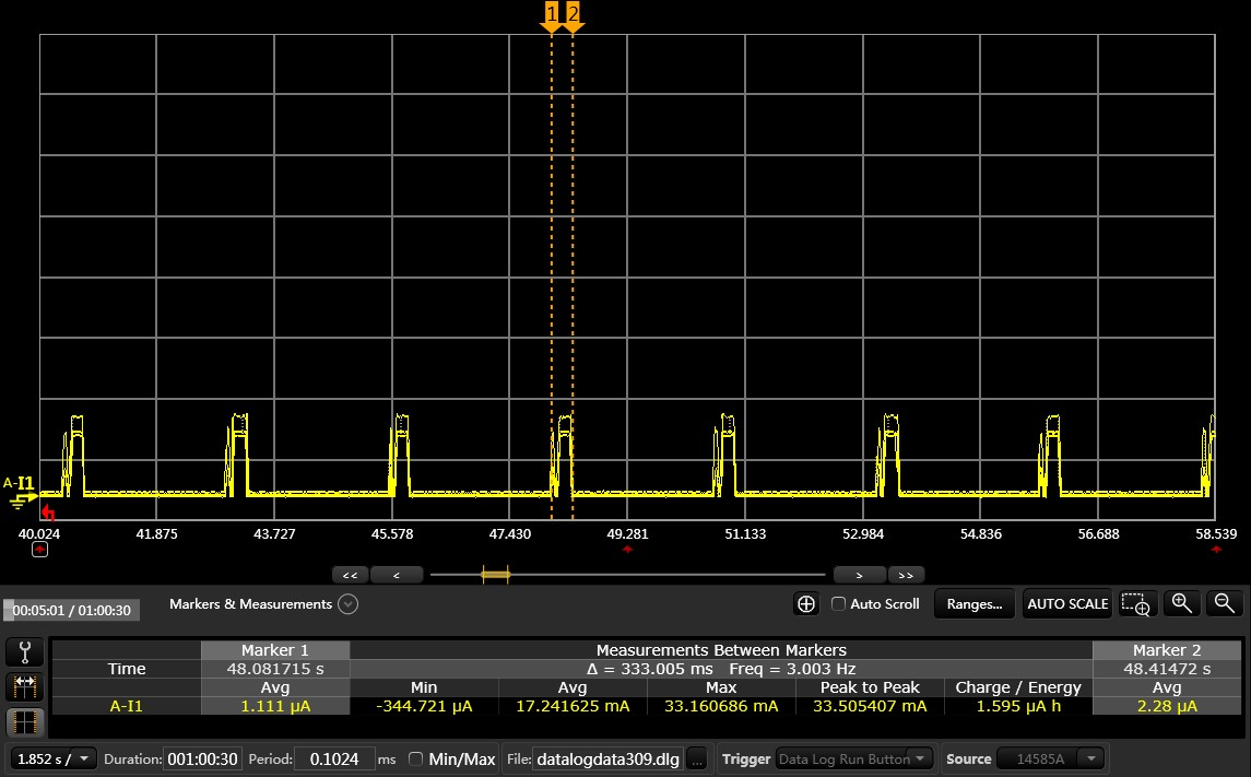

The average current during the nRF9160 test DRX is 2.2mA. The period of DRX is 2.56s. Using a China Mobile IoT card. I am testing on the DK board and have turned off all peripherals. The power consumption in psm is 4.4 uA.
Customers reported that the power consumption during DRX was too high. Mainly because the DRX window time is too long, as much as 300ms(The same IoT card).

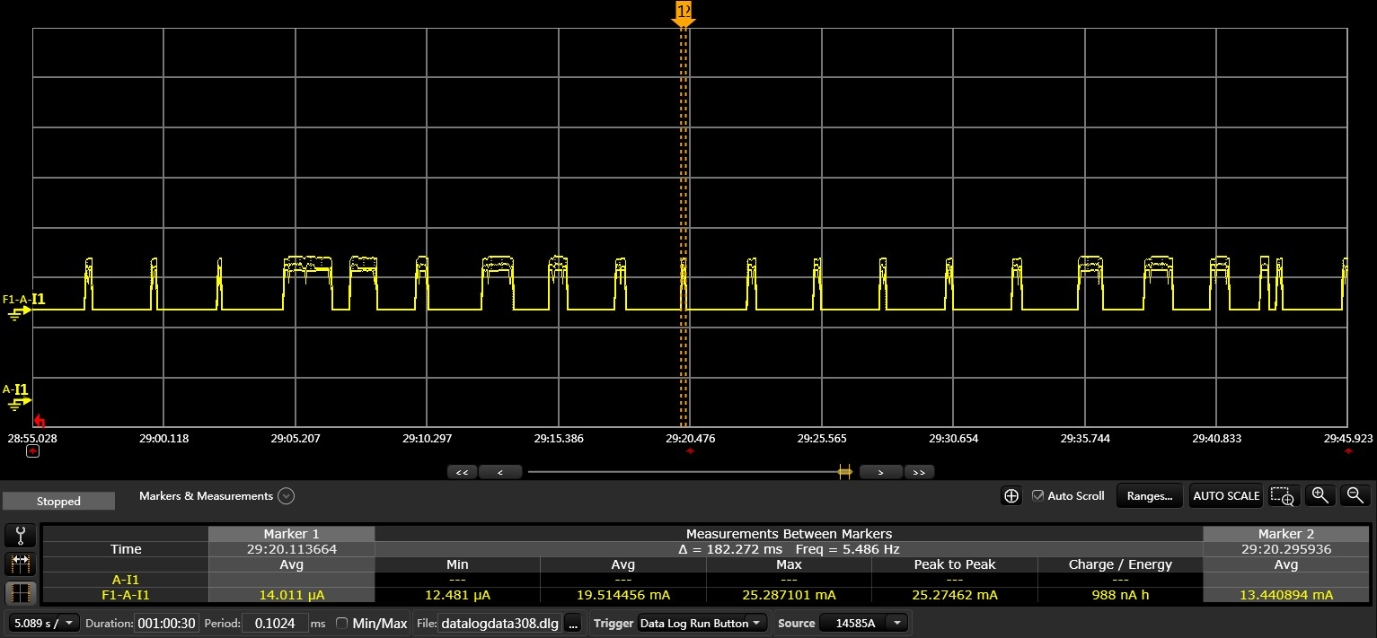

Customers use other manufacturers' NB modules for testing, and the window time of DRX is only 30-40ms().
How can I shorten the DRX window time to reduce power consumption.
