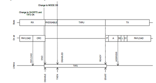

I am trying to change PHY after packet sent/received (known as asymmetric PHY).
After receiving EVENT_END, i write to register MODE to change the PHY.
This can be described :
Master:   TX(1M)-(change PHY)-----(TIFS)----------RX(2M)
Slave:     RX(1M)-(change PHY)-----(TIFS)----------TX(2M)
The problem is, this doesn't work on Slave, after RX with 1M, the slave do TX with 1M . I checked the register MODE on slave before and after TX, they changed to 2M, but the packet I observed on the sniffer was only 1M.
This worked on Master, I checked my implementation with other devices, and it works, as a master.
So I am wondering if this is a bug with the register MODE ?
