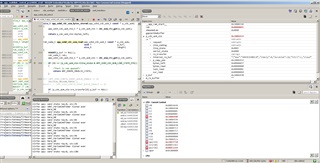

To reproduce this problem I first place a breakpoint at position A
I then ran the application and sent the message via a serial terminal with a Line Feed at the end.
It hits breakpoint A and the contents is as shown below with the complete message.
image 1

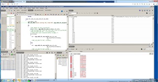

I then activate breakpoint B and click play.
I then resend the message changing it slightly i.e.
{"maw":"68B9D3D0BEC0","idonly":0,"duration":10,"fctrl":1,"cloud":1,"utc":1606456028,"type":"MQTT","fsrvid":"0%0","msg":"shake","rssi":-40,"scanenable":0}
At breakpoint B I look into my message buffer which should be NULLED from the memset but see it has the first character of the second message at index 154
image 2

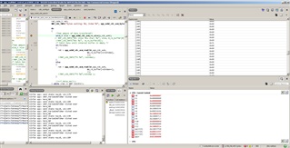

I then step into function 'app_usbd_cdc_acm_read' as shown below
image 3

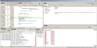

This shows that the message was received by the USB_CDC_ACM HAL layer okay but the index last_read is off by 1 byte thereby causing m_rx_buffer to be off by one and the 2nd byte of the sent message be in the first byte of my m_rx_buffer.
image 4
It looks like once the APP_USBD_CDC_ACM_USER_EVT_RX_DONE is hit, the first byte of the sent message has already been read by the HAL layer before function 'app_usbd_cdc_acm_read' has been executed.
Can you please fix this issue or suggest a way around it when processing APP_USBD_CDC_ACM_USER_EVT_RX_DONE events for messages greater than 64 bytes
Jes
  • Hi Jes,
    I couldn't get your code completely (it's not clear what exactly does firstRx and why you're using post-increment and pre-increment in different cases), but the reason of lost character seems clear. The function app_usbd_cdc_acm_read() doesn't simply read characters from internal buffer - it tells the driver that you're allocated a buffer to receive characters, and this buffer will be filled right after return (if there are enough charachers in the internal buffers), or upon a next APP_USBD_CDC_ACM_USER_EVT_RX_DONE when the next portion of data is received. At the end of your handler you're clearing m_rx_buffer and rx index, but the driver still has a one-byte buffer passed in the last call to app_usbd_cdc_acm_read() - so the first byte of your second message comes there.

  • Firstly thank-you for your quick reply. I have just given you a section of code for you to look at. I understand what you are saying that a buffer is passed to the driver to be filled. I have been trying various methods to get a completed message from start to end. The first message comes thru okay it is the second message onward that has the problem.
    Yes, after '\n' you set rxIndex=0 but app_usbd_cdc_acm_read() is already called to prepare receiving a next character somewhere at the middle of your buffer, you should change the logic to pass a pointer to first byte when the buffer is cleared. BTW, reading characters one by one is not a best way in your case, take a look at app_usbd_cdc_acm_read_any() - it will fetch all pending data without waiting the buffer to fill completely.
