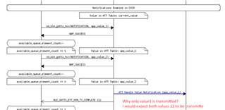

Finally looking at the GATTS Handle Value Notification diagram I cannot understand in Variant#2 why only app_value_1 is transmitted.. I would expect both app_value_1 & 2 to be transmitted.
Also in Variant#1 of  GATTS Handle Value Notification diagram, when trying to add app_value_3 in ATT table, NRF_ERROR_RESOURCES returns, while after adding  app_value_4 it returns NRF_SUCCESS. I cannot understand this.. Could you please explain?

    There is a difference between "Att table" and the softdevice buffers. They are not the same. The softdevice buffers are the buffers for the out going packets, the notification packets for example. When the ATT table is the table that store the value of the attribute locally. They are not the same. For example in the Variant #1 case you pointed to, the sd_ble_gatts_hvx(app_value_3) returned ERR_RESOURCE (for some reasons, explained later) then that mean the notification for app_value_3 will not be queued, but the value in the att_table is still updated.
    And then the next call for sd_ble_gatts_hvx(app_value_4) success and the notification packet will be queued, and the local att_table is updated. Only 3 notification packets will be sent.
    It's true that you can send 6 packets (or even more) in one connection interval, but there is no guarantee that you always can send 6 packets. If the event length is not configured long enough for such many packets, or if the peer device doesn't want to take multiple packet, you will have less. Also the buffer size can be 6 (or more) but it can be other activities that require some of the buffers. So you may have less number of the notification packet you can queue.
    Even if a packet is queued, there is no guarantee that it will be sent in the next connection event. As I mentioned, the peer device may only accept 1 packet per connection event. This answer your question on why in variant #2 app_value_1 and app_value_2 is not sent at the same connection event.

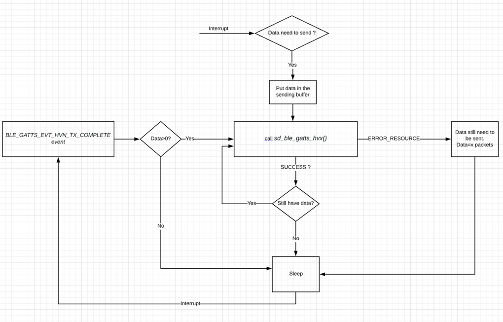

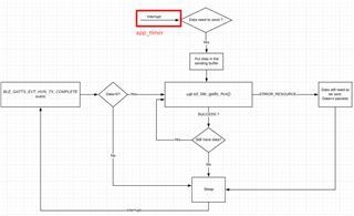

  • Thank you Hung, now things are much more clear to me
     In the code, you can just break after you receive NRF_ERROR_RESOURCES. After that you wait for BLE_GATTS_EVT_HVN_TX_COMPLETE
    Using a timer something like that I believe should be fine right?
    I believe the reason that could cause the sd buffer to get full is in case that buffering happens faster than the packet transmission, right? So, what are the possible reasons that could cause the packet to not be transmitted and remain in the sd buffer causing high queuing and finally NRF_ERROR_RESOURCES?
  • Yes, if you have more packet queued than the number of packets being sent you will have NRF_ERROR_RESOURCE.
    I don't see much point of keeping a timer in this case.
    You can think of doing something like this:
