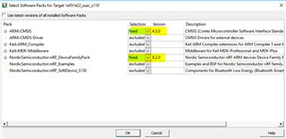

    Where does that mystery nRF5x_MDK_8_2_0_Keil4.msi install its junk? What does it do?
    Are you running arm5_no_packs? If not use the project in \pca10028\arm5_no_packs If you open Select Software Packs, what are selected, it should be ARM::CMSIS 4.5.0 and nRF_DeviceFamilyPack 8.2.0. If not open Pack Installer and click the green arrows to check for update.

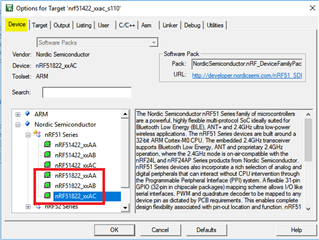

    brianreinhold said:
    I want to switch it to nrf51822. I have found databases, pack installers, but NO way to change targets.

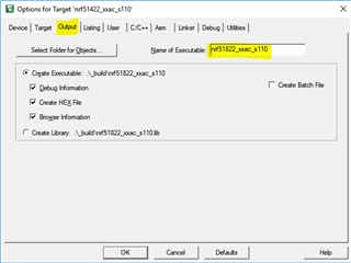

    You could change the target from porject -> Option for target -> Device
    Change the output name:
    -Amanda H.
