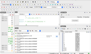

Somewhere bellow you can see the RTT from NRF52840 and the terminal from NRF9160.
The AT commands sent have no answer / no feedback, expecting something like when I use the LTE Link Monitor where I see an OK sent back, or when I see the modem ICON turning green.
Please advise what steps did I miss.
Thank you!

Terminal log for NRF9160:
