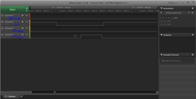

Hi. I am trying to use PIN 0.19 as my SPI CLK but it is always low.
Previously, I tried to change the pin to 0.26 and it works.
Is there any other configuration required for this pin?

Did you measure the pin on the pin header on the DK? This pin is connected to the QSPI External memory on the DK, and is not connected to the pin header. You can connect it by soldering some solder bridges, as described in the link.
Jørgen
Yes I did measure the pin and it is always low. I did not know it is connected to the QSPI External memory. Thanks for the info.
