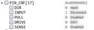

I have a question about setting the gpio pin status. From the picture, it seems that the value on the right represents the status of the gpio pin. So the default value is 2, which means using input mode and disconnecting with input buffer, right? Can we set the status by writing the value with "nrf_gpio_pin_write".  For example, "nrf_gpio_pin_write(17,1)" and "gpio_pin_cfg_output(17)", are those two sentences have the same function?
Actually, I have tried to use "nrf_gpio_pin_write", but it never works. I have configured the corresponding pin as output, but I still cannot write value to that pin. Could you please tell me what is the possible reason for this?

  • Thanks very much for your fast response. The picture shows all my main function in my project. I do not configure this pin anywhere else, even in the sdk_config.h. But when I checking the register, the output is not clear after "nrf_gpio_pin_clear(19)", and you can see I cannot even set the breakpoint to check the "nrf_gpio_pin_write" (no arrow mark on the left). Do I miss something in order to change the status of the gpio pin?
  • The code is okay. And the debug message told you it's output. However, I think your debug break-point is wrong. Because the main loop should for(;;) or while(1) loop. Even through you trace the function. You should make the break-point with some command.

    The state of the pin is not reflected in the PIN_CFG register, you need to read the IN register to get the state of pins configured as inputs. To read state of pins configured as outputs, you can read the OUTSET register.
    nrf_gpio_pin_write() will only call nrf_gpio_pin_clear() or nrf_gpio_pin_set(), depending on the second argument (0 will clear, 1 or above will set).
