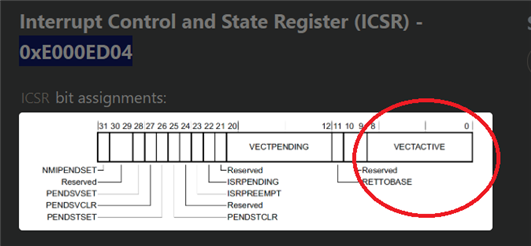

    The ARM register SCB->ICSR would be best thing to look into to know the context of the CPU state (ISR or Thread). I find this external page very useful when it comes to Cortex-M4 interrupt context. If you look at the ICSR section you can see that this register has VECTACTIVE register which you can poll to know the current context.
    For example if you see that
    SCB->ICSR & SCB_ICSR_VECTACTIVE_Msk )
    Then it means that you are executing in the thread context and not in any ISR.
    A non zero number would give you the raw interrupt number from which you need to substract 16 (Since nRF implements only 4 bits of these) to get the interrupt number mapped on nRF device

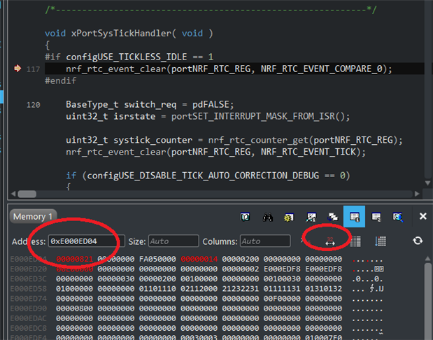

  • samsam said:
    Is there a way to see this register in debug mode at a breakpoint? I dont see this register exposed in SES in any of the registers groups
    I put a breakpoint in FreeRTOS RTC interrupt handler, Start debugger in Segger IDE->View->Memory and put 0xE000ED04 as shown below
    You can see that 0XE000ED04 has the value of 0x00000821
    From the register definition below
    The first six bits of the register address will give the active vector number, so, from 0X0000821, the first 6 bits will be 0x21 which is decimal 33.

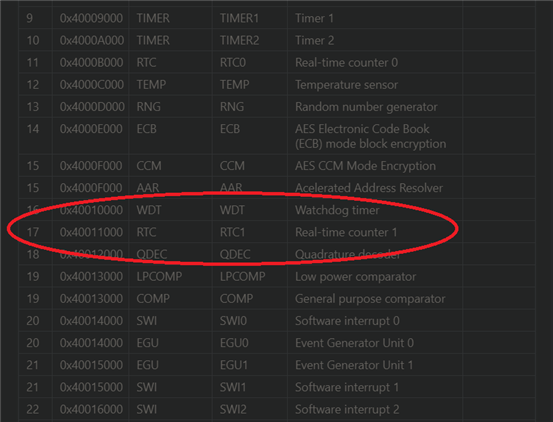

    You need to substract 16 from this as this is the offset to get the platform based ISR number. So 33-16 = 17.
    From the memory map of nRF52832 you can see that number 17 is RTC1
    That is exactly we put the breakpoint and hence you can see that the SCB-ICSR value can give us the context of the interrupt you are running. If VECTACTIVE is 0, then you are running in Thread mode.
