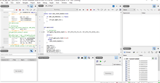

I cannot get the NRF_LOG messages via RTT to the debug terminal in SES or RTT Viewer.
My setup:
HW: PCA10040
SDK: 17.0.2
Project: nRF5_SDK_17.0.2_d674dde\nRF5_SDK_17.0.2_d674dde\examples\ble_central\ble_app_uart_c
SES: 4.50
My project compiles and it runs. ble_central works fine.
I expect to see this line printed to the integrated Debug Terminal in SES but I do not.
My modifications to sdk_config.h:
 NRF_FPRINTF_FLAG_AUTOMATIC_CR_ON_LF_ENABLED 0
NRF_LOG_BACKEND_RTT_ENABLED 1
NRF_LOG_BACKEND_UART_ENABLED 0
NRF_LOG_ENABLED 1
NRF_LOG_DEFERRED 0 (tried both 0 and 1)
I can very rarely see the log output with RTT Viewer with the following settings.
Same issue i found on 15.3 it worked, after changing configs.
#define NRF_FPRINTF_FLAG_AUTOMATIC_CR_ON_LF_ENABLED 1
to
#define NRF_FPRINTF_FLAG_AUTOMATIC_CR_ON_LF_ENABLED 0
Please suggest.
